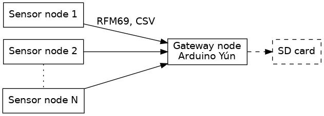

The Open Hive Box RFM69 is a sensor node transmitting data using radio link communication. Telemetry data is serialized using CSV and transmitted to the receiver node Open Hive Arduino Yún gateway or Open Hive JeeLink radio gateway.

// Synopsis of Open Hive RFM69 sensor node
digraph open_hive_rfm69_sensor_firmware_synopsis {
    // Options
    rankdir=LR;
    ranksep=0.5;
    // Style
    //graph [splines=ortho];
    node [pin=true, shape="box", fontname="Verdana"];
    edge [fontname="Verdana"];
    // Graph nodes represent hardware node units
    "sensor-1"      [label="Sensor node 1"];
    "sensor-2"      [label="Sensor node 2"];
    "sensor-N"      [label="Sensor node N"];
    "gateway"       [label="Gateway node\nArduino Yún"];
    "sd"            [label="SD card", style=dashed];
    // Graph edges represent radio families and
    // protocols spoken between node units.
    "sensor-1"      -> "gateway"        [label="RFM69, CSV"];
    "sensor-2"      -> "gateway";
    "sensor-N"      -> "gateway";
    "gateway"       -> "sd"             [style=dashed];
    // Draw a dotted line between sensor-2
    // and sensor-N, but retain node positions.
    "sensor-2"      -> "sensor-N"       [dir=none, style=dotted];
    {rank=same; "sensor-1"; "sensor-2"; "sensor-N" };
